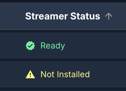

The device list on Settings → Remote Control shows every device and its Streamer Status:
  • Ready — Streamer installed and registered
  • Failed — Streamer failed to install or register
  • Not Installed — setup has not been started

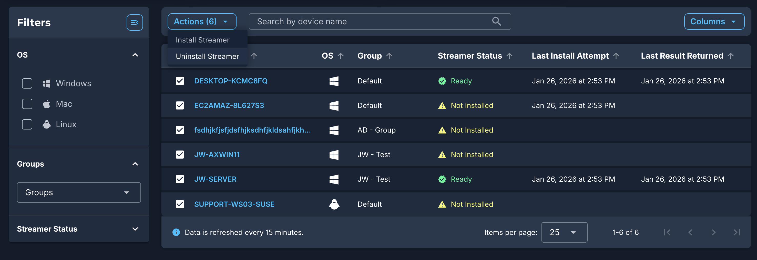

To remove the Streamer from devices it has already deployed to:
  1. Go to Settings → Remote Control.
  2. Narrow the list to the devices you want using the Filters (OS, Group, Streamer Status) on the left, or the Search by device name box. To target everything currently installed, filter Streamer Status to Ready.
  3. Select the devices using the checkboxes. Use the header checkbox to select all devices in the filtered view.
  4. Open the Actions dropdown and choose the uninstall option.
The Streamer is removed silently. Once uninstalled, Remote Control is unavailable on that device until the Streamer is reinstalled.

After an action, watch the Streamer Status, Last Install Attempt, and Last Result Returned columns for each device to confirm the outcome. Status data refreshes every 15 minutes, and offline devices process the command the next time they check in.
