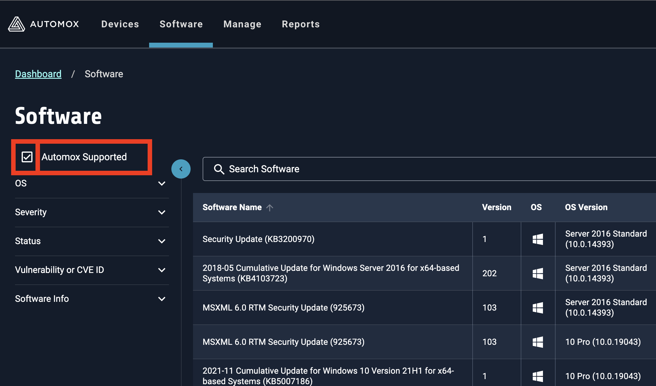

You may notice that an application is visible on the Device Details page but not listed on the Software page. This discrepancy is due to the filtering settings on the Software page.
Solution: Display All Applications
  1. Navigate to the Software page in the Automox console.
  2. At the top of the filter panel, locate the checkbox labeled "Hide Unsupported Software" (enabled by default).
  3. Uncheck this box.
    • This will reveal all applications and software packages installed on your devices, including those that Automox does not natively support for patching or updates.
