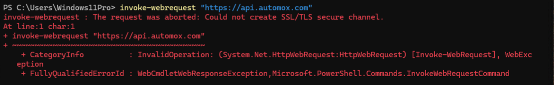

On Windows devices, scans and policies fail and return the following error:
The request was aborted: Could not create SSL/TLS secure channel.
This error prevents the scan/policy from completing successfully.

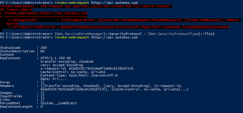

This manifests with the following error when attempting to connect to an Automox endpoint via PowerShell:
Invoke-WebRequest "https://api.automox.com"
This error indicates that something went wrong with the TLS handshake. If TLS 1.2 is enabled, it's most likely not being enforced in Powershell. Forcing it with the following command will work in that session, but not for Powershell as a whole:
[Net.ServicePointManager]::SecurityProtocol = [Net.SecurityProtocolType]::Tls12
If that resolves the behavior, you can force Powershell to use TLS1.2 persistently by following this article: Force PowerShell to Use TLS 1.2

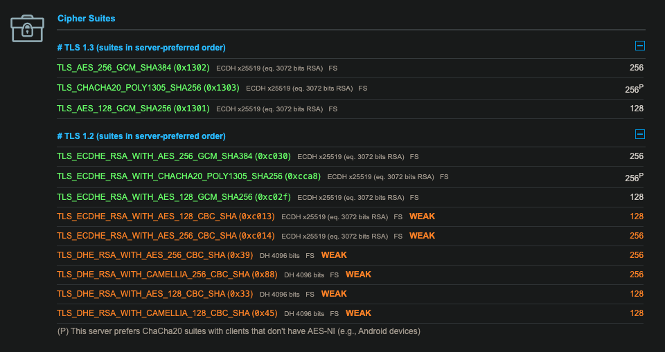

Use SSL Labs to validate the necessary Cipher Suites for Automox download URLs:
Example SSL Labs output (as of 12/18/2025):

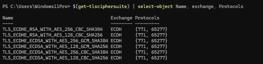

Running this PowerShell command gets us the available Cipher Suites:
$(Get-tlsciphersuite) | Select-Object Name, exchange, protocols
Example output:
Name                                    Exchange Protocols
TLS_CHACHA20_POLY1305_SHA256                     {772}
TLS_AES_256_GCM_SHA384                           {772}
TLS_AES_128_GCM_SHA256                           {772}
TLS_ECDHE_RSA_WITH_AES_256_GCM_SHA384   ECDH     {771, 65277}
TLS_ECDHE_RSA_WITH_AES_128_GCM_SHA256   ECDH     {771, 65277}
TLS_ECDHE_RSA_WITH_AES_256_CBC_SHA384   ECDH     {771, 65277}
TLS_ECDHE_RSA_WITH_AES_128_CBC_SHA256   ECDH     {771, 65277}
TLS_ECDHE_ECDSA_WITH_AES_256_GCM_SHA384 ECDH     {771, 65277}
TLS_ECDHE_ECDSA_WITH_AES_128_GCM_SHA256 ECDH     {771, 65277}
TLS_ECDHE_ECDSA_WITH_AES_256_CBC_SHA384 ECDH     {771, 65277}
TLS_ECDHE_ECDSA_WITH_AES_128_CBC_SHA256 ECDH     {771, 65277}
The Protocols are correlated from their decimal translated value:
    0x0303: "TLS_1_2", # 771
    0x0304: "TLS_1_3", # 772
    0xfefd: "DTLS_1_1", # 65277
If TLS 1.3 is not enabled, the only Cipher Suites available are used with ECDH.
If ECDH Key Exchange is not enabled, we have no viable Cipher Suites.
If TLS 1.3 Cipher Suites are not enabled
Similarly, if TLS 1.3 is enabled, but the only Cipher Suites available do not match what is required by api.automox.com, then the TLS handshake can fail.
Note that none of the available Cipher Suites match what is accepted from the SSL Labs output.

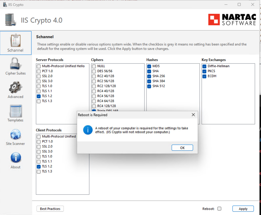

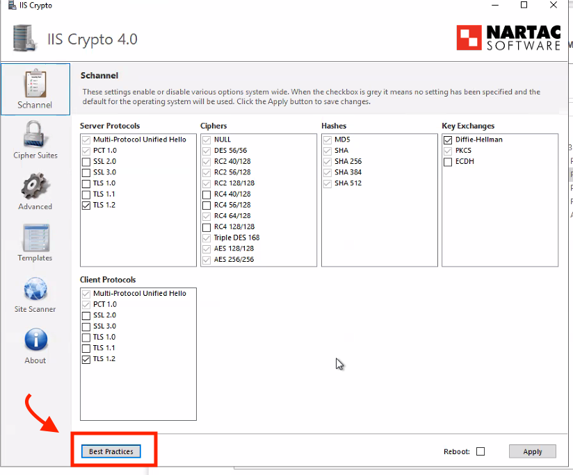

IIS Crypto Method to Enable ECDH
Step 1: Install IIS Crypto

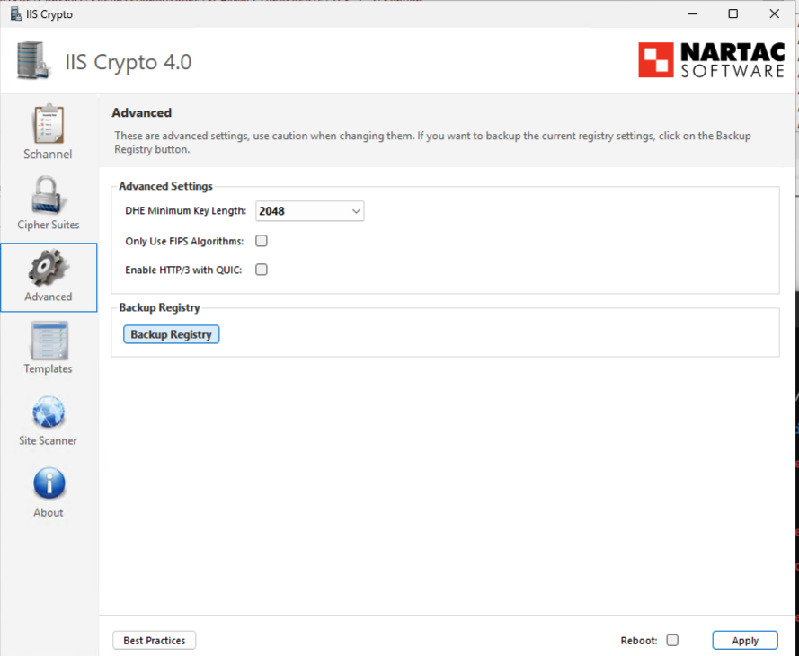

Step 2: Take a backup of the Registry
  • Open the Advanced tab.
  • Click Backup Registry.
Step 3: Open IIS Crypto on the device and verify the current configuration
  • Click the Schannel tab.
  • Note the Server Protocols, Client Protocols, and Key Exchanges sections.
IIS Crypto
X

Step 4: Enable ECDH and click Apply
  • On the Schannel tab, check the "ECDH" checkbox in the Key Exchanges section.
  • IIS Crypto will recommend a reboot, but this is not strictly necessary (though recommended).

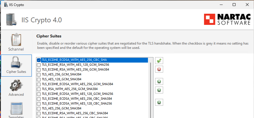

IIS Crypto Method to Enable  Cipher Suites
  • Click the Cipher Suites tab.
  • Note the enabled Cipher Suites.
Step 4: Enable the necessary Cipher Suites and click Apply

Final Step
In the same IIS Crypto 4.0 application, and if after all the previous steps have been implemented, use the "Best Practices" button and restart the device.
