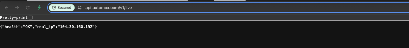

Option 2: Using a browser, navigate directly to the target URL
Open a browser of your choice, and enter the URL into the address bar. On success, you will see a form of the following response per URL:
https://rtt.automox.com/.well-known/jwks.json
https://api.automox.com/v1/live
