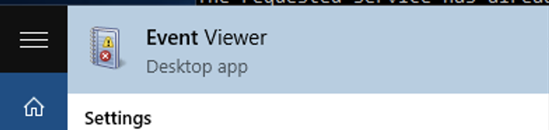

  1. Open Event Viewer
    Opening Event Viewer

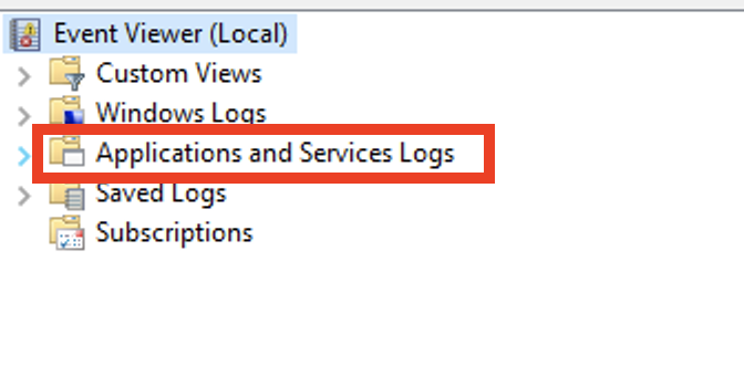

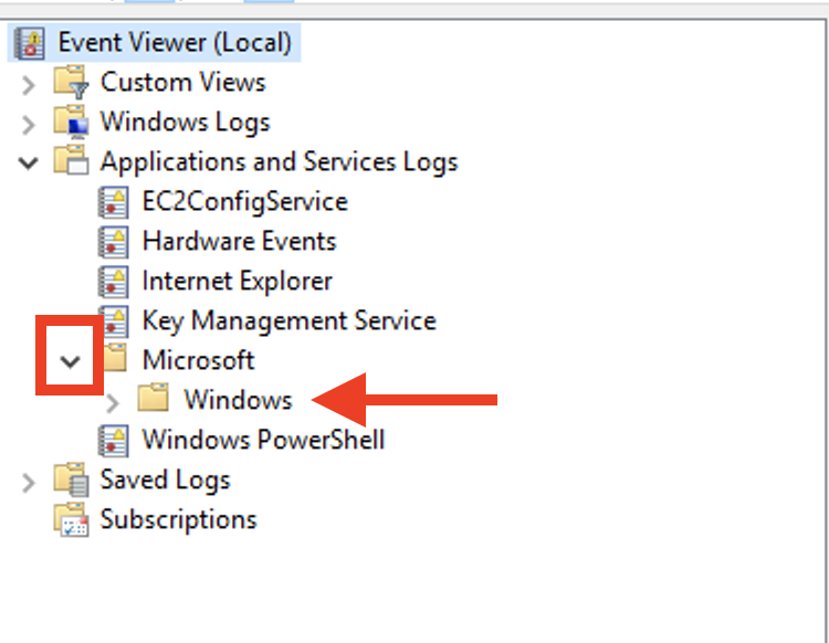

  2. Expand the Applications and Services Logs section, then expand Microsoft > Windows.
    Applications and Services Logs in Event Viewer
    Expanding Microsoft and Windows in Event Viewer

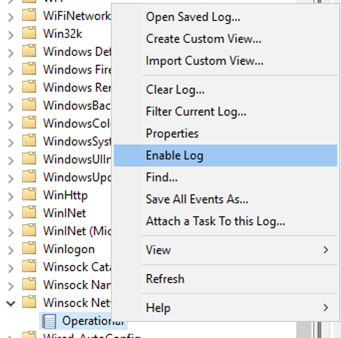

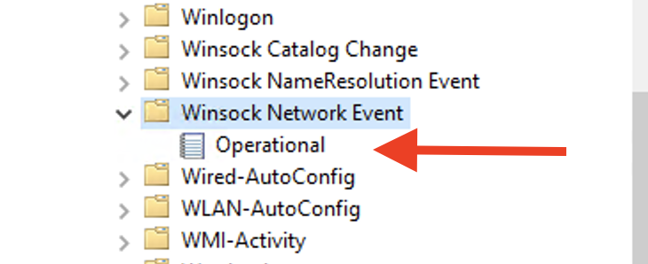

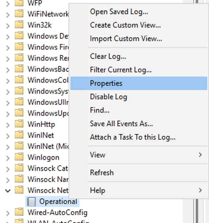

  3. Scroll to the bottom, expand Winsock Network Event, right-click Operational, then select Enable Log.
    Winsock Network Event in the Event Viewer tree
    Enable Log on the Operational channel

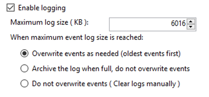

  4. With logging enabled, configure it. Open Properties, set the maximum log size to 6016 KB, roughly 6 MB, and set the behavior when the maximum is reached to Overwrite Events as needed.
    This channel can be busy on an active device. A capped size with overwrite enabled keeps it from filling and stopping, so recent activity is always retained.
    Operational channel Properties dialog
    Setting maximum log size and overwrite behavior

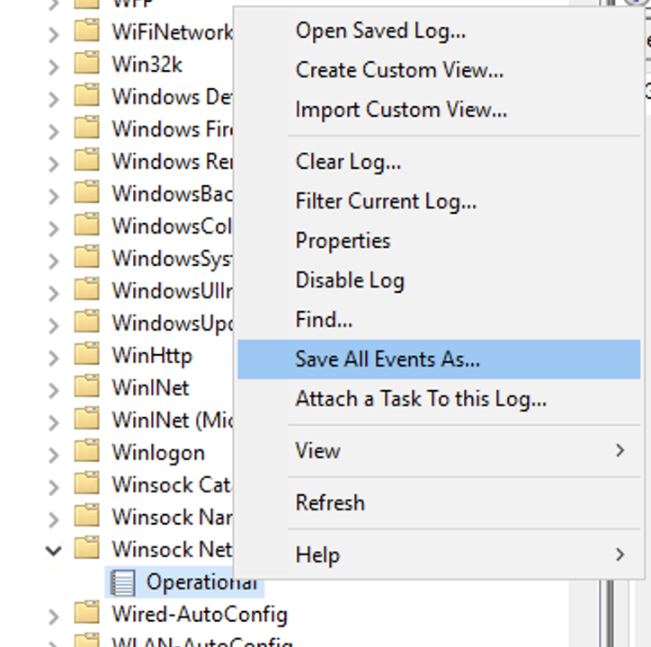

  3. To export, right-click Operational and select Save All Events As...
    Save All Events As on the Operational channel

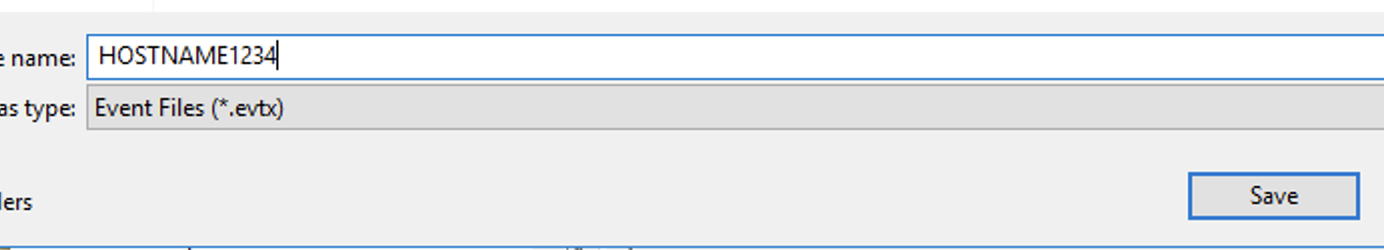

  4. Name the file after the device hostname, then click Save. Attach it to your support ticket along with the approximate time of the disconnect.
    Saving the exported event log named by hostname
