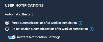

- Open the User Notifications section and enable Force automatic restart after Worklet completion. This is what actually reboots the device.
