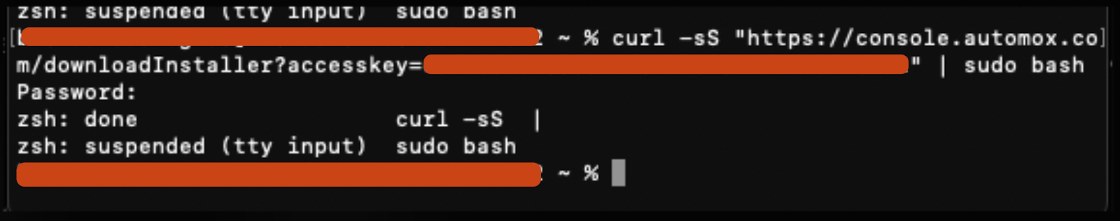

3. If the pasted command behaves unexpectedly in your shell
macOS uses zsh as the default shell. In some environments a command pasted into Terminal is not interpreted as intended, and running the same command in bash resolves it. If the command fails in a way that looks like the shell mishandled it, rather than a permissions or key error, switching shells is worth trying.
Check the current shell:
echo $SHELL
Switch to bash for the installation:
exec bash
Return to zsh afterward:
exec zsh
This is environment-specific and is not the usual cause of a failed installation. If switching shells does not change the result, the problem is elsewhere, so return to the checks above and then collect logs.
Terminal output during an Automox agent installation on macOS
