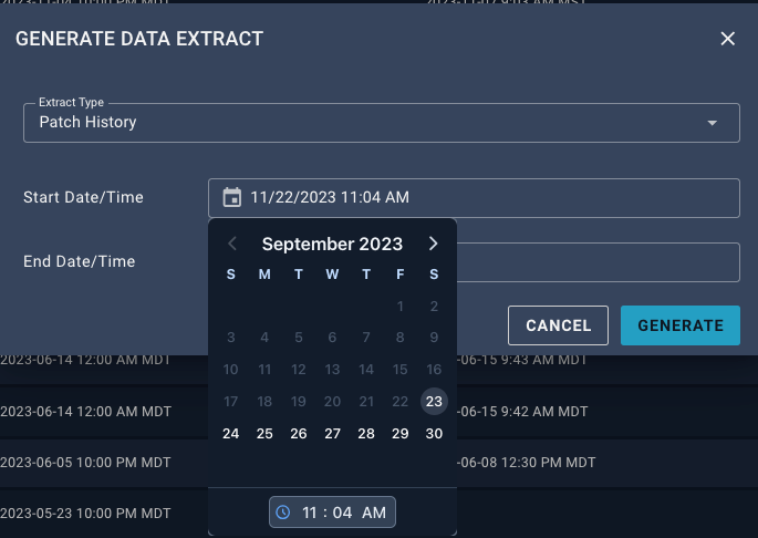

Data Extract
The Data Extract feature provides comprehensive reporting but has a strict historical limit.
  • Limit: Data Extracts can only retrieve data from the last 90 days.
  • Usage: It is not possible to generate a Data Extract report that goes back further than 90 days from the current date. The date range filter in the console will automatically adjust to enforce this maximum range.
