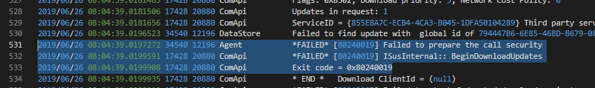

When you have your log file and are ready to dig in, start by looking around the time your patch failed. Each line has a timestamp (Local system timezone) that can be used for reference. Additionally, or optionally, you can search for the particular patch KB number that you're having issues with.
Now that we have an idea of where to look, we usually look for an error code of some sort to point us in the right direction.
These error codes almost always look like these shown here. Starting with "8024" and accompanied by "*FAILED*" or "Exit Code".
After you find your Error Code, check it against our reference page or check out Microsoft's Documentation for the specific code you're seeing.
