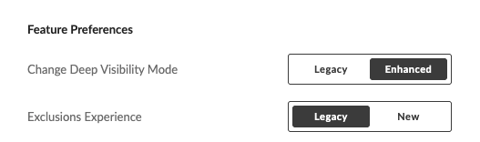

  1. Open the SentinelOne Management Console:
    • Log in to your SentinelOne console with an account that has the necessary permissions.
  2. Navigate to the Exclusions Menu:
    • Go to Policy Settings or Global Settings (depending on your configuration).
    • Select the appropriate group or device policy where you want to apply the exclusion.

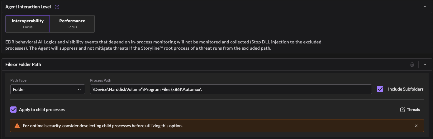

  3. Add the Exclusion:
    \Device\HarddiskVolume*\Program Files (x86)\Automox\
    • Include Subfolders: Yes
    • Exclusion Type: Path exclusion for both alerts and mitigations.
    • Exclusion Mode: Interoperability - extended.
  4. Save the Configuration:
    • Save your changes and allow approximately 5 minutes for the exclusion to propagate.
  5. Reboot and Test:
    • Restart the device to apply the changes.
    • Verify whether Automox is functioning correctly.
If there are still issues with processes being blocked, try setting the Exclusions Mode to Performance Focus - extended
